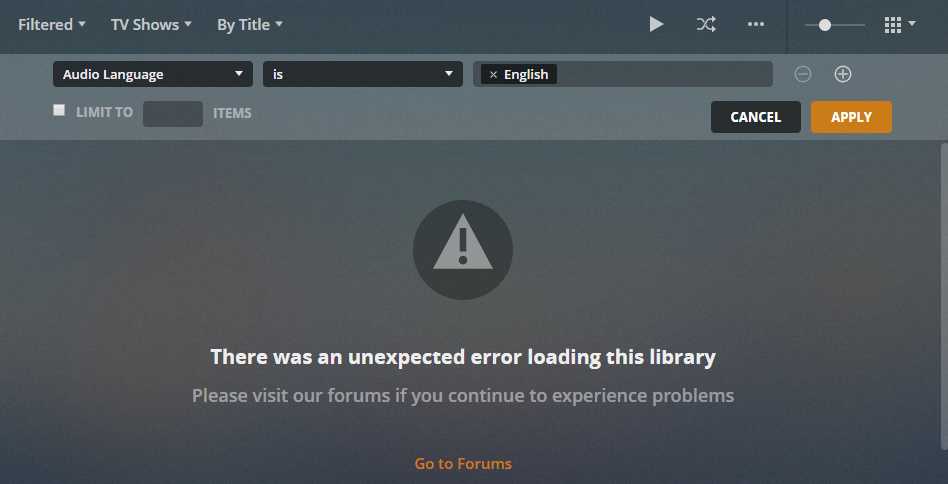

Hello,
I got an error message on Plex Web when I am in a TV shows library named “Séries TV” and try to do a customer filter for searching specific audio language
In the log we find that :
Apr 22, 2019 20:56:42.944 [16188] DEBUG - Setting container serialization range to [0, 49] (total=-1)
Apr 22, 2019 20:56:42.944 [16188] ERROR - SQLITE3:0xb8f01689, 1, no such column: grandchildren.id in "select count(*) from (select distinct(metadata_items.id) from metadata_items  where metadata_items.library_section_id in (4) and (metadata_items.metadata_type=2 and (select
Apr 22, 2019 20:56:42.960 [16188] ERROR - Soci Exception handled: sqlite3_statement_backend::prepare: no such column: grandchildren.id for SQL: select count(*) from (select distinct(metadata_items.id) from metadata_items  where metadata_items.library_section_id in (4) and (metadata_items.metadata_type=2 and (select count (*) as cnt from media_streams join media_items on media_items.id=media_streams.media_item_id where media_streams.language='eng' and media_streams.stream_type_id=3 and media_items.metadata_item_id=grandchildren.id) > 0) )
Apr 22, 2019 20:56:42.960 [6004] DEBUG - Completed: [127.0.0.1:64300] 500 GET /library/sections/4/all?type=2&episode.subtitleLanguage=eng&includeCollections=1 (10 live) TLS GZIP Page 0-49 7ms 484 bytes (pipelined: 6)
All other custom search is ok except audio language and subtile language.
I don’t have the issue in my Movies Library.
Could someone try on your side ?
Here the error.
I tried to repair the DB following the support page but no luck.
I also tried to install a new server and only adding 1 file but no luck.
Best Regards.

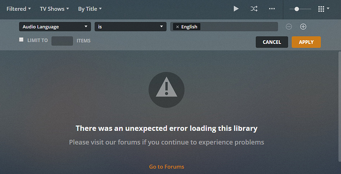

I have the same problem and error screen. It worked in the past.
Server Version 1.15.4.993
Confirmed the error. I have filed a bug report.
Workaround:
if you set the library view mode to ‘Seasons’ or ‘Episodes’, the filter is working.
I have the same error, it looks like this bug is still outstanding? I can confirm workaround does work.
Looks like it will be fixed in server version 1.16.3
