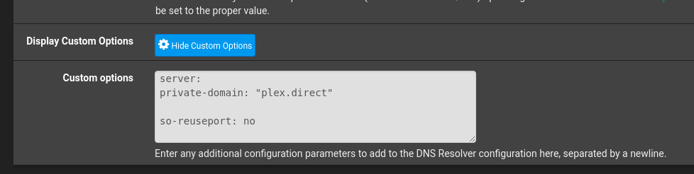

  3. I use a local domain (XXX.LAN). To make this work, I needed to create a DNS rebinding exemption rule in the local DNS service to allow the overlay domain “plex.direct” to occupy the same space. On pfsense, it looks like this:
  1. You will likely need / want to add similar for your FQDN to start then also add the FQDN identification to Plex in “Settings - Server - Network - Show Advanced”.
