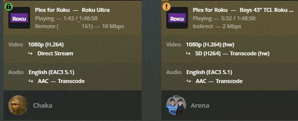

Update 1.18.9.2571 (~march 26th) caused some to have to use Relay and not others
Server Version#:1.18.9.2571
Sometime this week one of my family members lost the ability to connect securely so everything is now streaming at 2mbit max. It is the case for their Windows app, Web browser, Roku TV app, and a stand alone Roku Premier. At another family members, they have not seen any change with their Roku and connect at full speed. The problem house hasn’t updated anything that they are aware of (not technical so they don’t touch the network.) The server hasn’t had any issues with having remote access enabled (that is after it broke a few months ago and I had to set up manual port forwarding).
I re-setup the Plex for Windows on their pc and got a message that ‘the server was not set to allow for secure connections’ even though it was currently set at Required (though I tried preferred and saw no change). I have to Enable Relay on the server for them to see anything.

Changed the title of this post as it turns out it wasn’t anything directly to do with changes on their side as I saw a comment from another user noting external problems with this release that were fixed by a rollback to 1.18.8.2527. I noticed my server had an update on the same day they lost connectivity.
Rolling it back to 1.18.8.2527 immediately resolved the issue and they are able to connect directly and stream at full bitrate.
Again, it did not affect another location or my ability to connect directly via my cell phone (wifi off/cellular network).
