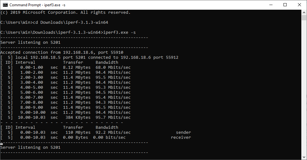

I have also tested my LAN network with iPerf

This says that the TV received the stream at a rate of about 1MB / sec. Your speedtests appear to be from another computer to your server. That won’t tell anything about how your TV is doing.
True. I did the test from a Pi in the same LAN because I don’t know how to do a local speedtest from the TV. Thought it would be the same data.
But your comment made me think. I have done another test from a laptop using the TVs RJ45 cable, just in case, and the results where the same as showed in my previous post.
