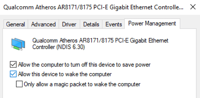

My server after a format and clean install of Windows 10 Pro was no longer waking up when in sleep mode when opening a Plex client.
I finally tracked the culprit down. Under Power settings for Windows, go to the ā€œChoose what the power buttons doā€ or whatever its called, on the left hand side. Click the ā€œChange settings that are currently unavailableā€ link and some checkboxes appear. I unchecked ā€œTurn on fast start upā€.
I also made sure that the network adapter power settings allowed wake on activity and not just magic packet.
And now everything works great. When the server is asleep, starting up a Plex client or starting an RDP connect will wake it up! Fantastic!

I have a solution: as a server let your connection ALWAYS up, and allow you computer to sleep.
When you want to reach your Plex Server, the Plex Player asks plex infrastructures to join your server on port 32400. The is a classic new tcp connexion, so it’s start with normal SYN packet. There is NO Magic Packet sent, Wake on Lan is not involved, Plex doesn’t rely on WoL. Second problem, when your computer is deeply sleeping for hours, the network card is off (the switch could be involved) and no packet could wake it, magic or not.
The solution :
1 - put a redirection of 32400 port on your LAN server static IP or let uPnP works.
2 - do NOT tick the ā€œonly allow a magic packet to wake the computerā€ on your network adapter. It’s not related to WoL magic. But you need a SYN packet to revive it. Do like in this post Wake on LAN (WOL) for Windows 10 PLEX Media Server when in sleep mode. Is it possible?
3 - Owners of Windows 10 HOME (PRO jump to 4) have to install the gpedit.msc, follow this solution https://www.itechtics.com/easily-enable-group-policy-editor-gpedit-msc-in-windows-10-home-edition/
4 - change local policy to let your network adapter active when your computer is sleeping according to this link https://www.howto-connect.com/keep-internet-connection-active-when-in-sleep-mode-windows-10/
5 - in power settings, advanced…PCI Express tab, you may have to choose OFF for Link State Power Management setting.
