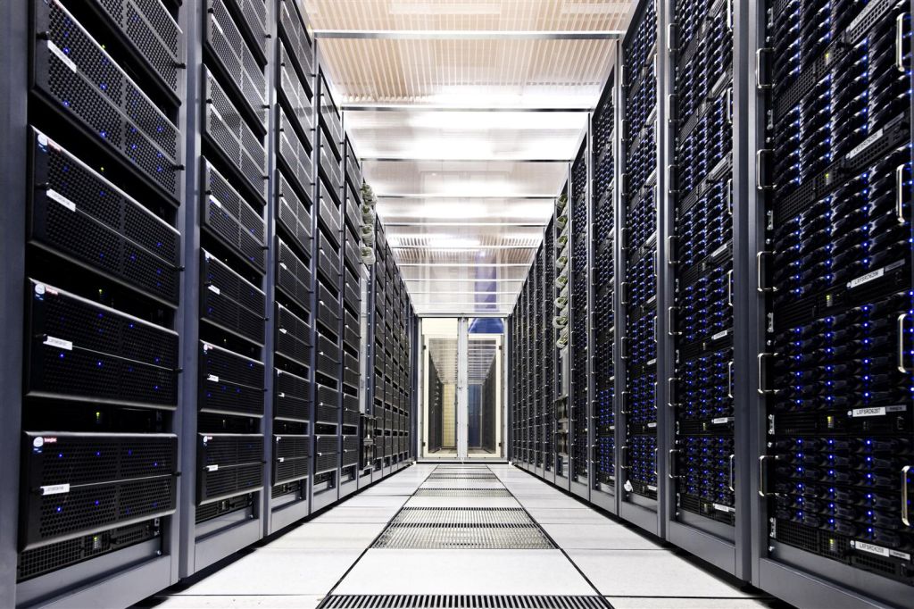

Plex is fantastic for the home user in that a standard home computer can, in most cases, transcode and deliver 1 or perhaps 2 1080p streams. Push that to 20 and you need one of these:
Media Preparation can be done quickly and easily enough by just about anyone with a few skills and the willingness to do the work and that could mean the difference between buying the above or this one below:
