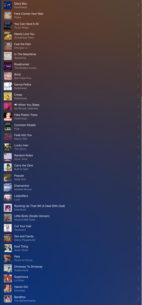

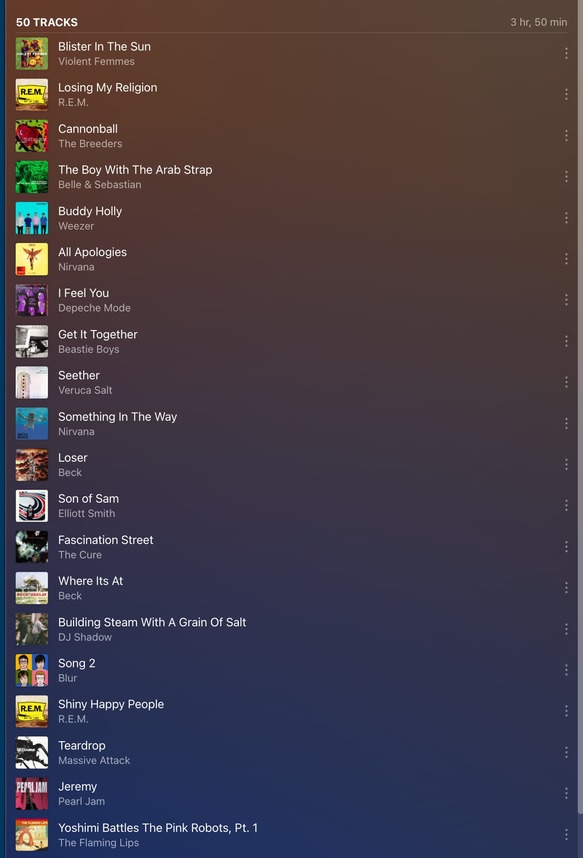

I’m including screenshots of the existing playlist (is there some other way to export a playlist?).
Sorry, I cannot deduce anything from these screenshots.
Please take attention next time you are activating one of the DJs.

I’ve been listening to this playlist for the past 45 minutes with DJ Gemini. There were a handful of tracks that weren’t ideal (The Cramps) but not entirely out of place.
I’ve now switched to DJ Stretch - “relatively surprising” seems accurate. Massive Attack > Roy Orbison with the Real Philharmonic > Electric Light Orchestra > R.E.M. > Pearl Jam.
