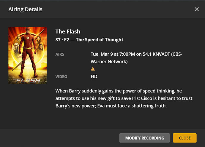

Yellow triange with ! in DVR Schedule
Would be nice to know why?
Hover your mouse over it, it should tell you.
Nope, doing that only inverts the color between the triangle and the circle. clicking it brings up the “Airing Details” window with the triangle icon added to the description but no details why.
Same thing on my system. I restarted plex on my NAS and it corrected it for a few days, but now is showing up again with an error. Running Version 1.21.4.4079. Appears to be no error message content.

ok. will need to look at logs to try to figure out reasons. it would usually be a conflict or the grab failed.
I’ll put in a request to have a tool tip or something on the triangle.

Several shows are still not recording. Some more information…
While trying to record, a tooltip did show up on the yellow triangle, and it stated, “Could not tune channel. Please check your tuner or antenna”. I am able to watch directly through the HDHomeRun app, but Plex won’t let me watch the channel and it wouldn’t record. Any ideas why this keeps happening?
