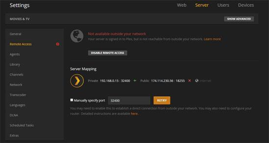

I still believe that if the system allowed a manual input of the IP (see image below) that this would solve the issue.
I am also not clear on the function of the CSA url in the network page. Why is this is on a separate page in the advanced functions AND why (if used) does this not show up as an over-ride to the IP that the plex system derives and then shows as failed to connect… (see image below)

Definitely manual IP entry is a must have feature for a server application.
