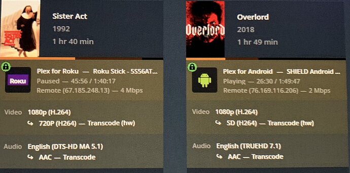

Just found this thread. I had hardware decoding working for a hot minute with 1.15.1.707 but I can’t get it working anymore. Using a Nvidia P2000.
@TeknoJunky So I know I had hardware decode working on 1.15.1.707. I have screenshots that prove it. However, I can’t get it working again at least not without a dummy displayport dongle. I was reading over in this thread and saw that he needed one for Intel QuickSync to work so I figured I would try and sure enough hardware decoding is working again now that I have a dummy dongle plugged in.
