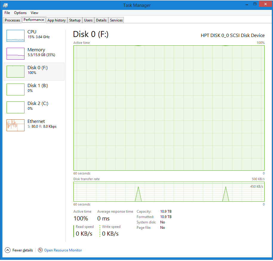

I noticed that on my Windows 8.1 desktop running the Plex Server, that my disk utilisation was 100%, yet the read and writes speeds were 0 or very little KB/s… ? As soon as the disk runs at 100%, the buffering starts.

Here is a screenshot of task manager. You can see disk 100%, but no read or write access speeds. CPU is always good and never high.

Hi @Guru_Panda - This to me would be a bit of a concern. You shouldn’t be seeing 100% disk usage whilst there are no read / writes happening. That’s essentially something that is kinda impossible!
So to me, that could either be Windows misinterpreting your RAID controller, or maybe even an indication of a problem with either the RAID controller on the Array itself.
I appreciate that you can see the behavior occur when you start using Plex, but in theory, that is only because Plex is accessing the Array.
The thing that sticks in my mind is, why does Windows report 100% usage whilst there are no read / writes happening, and that in itself may be a clue…
