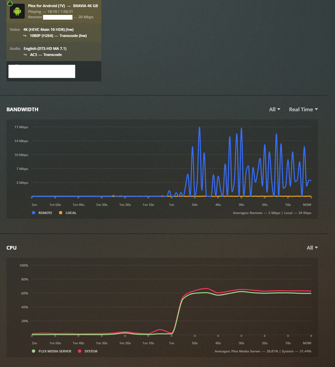

Looking into my log files, it appears it’s a transcoding rather than a network issue as the transcoder speed according to the logfile averages only around 0.3.
What’s surprising me is that despite this, the CPU utilization is at “only” 60% as seen here:
Is this normal and is the DS918+ simply not powerful enough to transcode a 4K HDR movie, even with HW acceleration enabled?

That is the reason. Disable “tone mapping” and things will go much smoother on the 918+

However, and I’m not sure if this is a bug, but when I select Convert to 1080p HD (High) 20 Mbps, the Dashboard shows me the following:
Can you see what’s wrong? It’s transcoding from 4K to 4K, but I’ve picked “1080p (High)”, so why am I getting a 4K output instead of 1080p?
Maybe that’s the reason why it’s buffering in that particular case, or maybe not, because I get a 4K to 4K transcode both with and without HDR tone mapping enabled with the “1080p (High)” option (but only the one with HDR tone mapping buffers every 10 seconds).
Thoughts?
