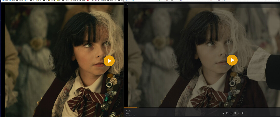

To answer your question:
The output of the Plex transcoder is 8-bit H.264 SDR video, irrespective of the input.
If you transcode HDR video with tonemapping disabled, you will see washed out colors. Some movies look worse than others, but without tonemapping the colors are off.
Left: Tonemapping enabled
Right: Tonemapping disabled.

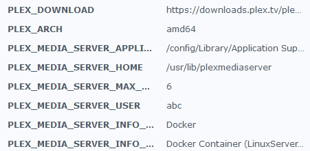

Are you referring to these variables and do I need to add a PLEX_GID entry (there isn’t one currently)?
If so, what value does the value need to use, or rather, how do I find out what the native apps GID is?
Where did you get those names from please?
I know the container to exist otherwise.
-e PLEX_UID=1001 \
-e PLEX_GID=1001 \
( -e sets the environment variable recognized by the pmsinc/docker package )
They are from the details screen of the docker container.
why are you using abc and not user plex (which has the permissions to write to the hardware) ?
The native package installer is what adds plex to the video group so it can access the HW.
These are default values of the linuxserver container. Do I need the change the PLEX_MEDIA_SERVER_USER entry from “abc” to “plex” in order to enable hw acceleration?
