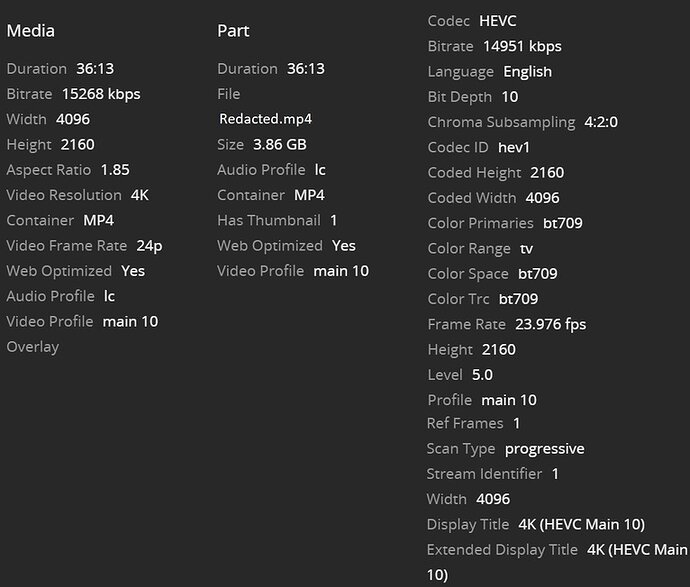

I’ve never been able to direct play full 4k resolution videos in the native Plex app on my shield. I can play them fine in Kodi, but in Plex they transcode saying the resolution isn’t supported on my device. These files direct play on my Android phone as well.
It would to know the specs of the video and your TV. The shield can play just about anything you can throw at it so I suspect it is a limitation of the TV. Assuming it is a local TV on your network. Remote is a different story.
I have a Sony X950G that can handle up to 4096x2160p video signals according to it’s specs. I’ve attached an example video’s info:

I checked the mde messages in the server log and it has “media must be transcoded in order to use the hls protocol”. The player reason says the resolution isn’t supported. The server logs say that it tries to remux into an mkv, but that fails as well.

This is still an issue. The transcoding reason is that the Shield Pro doesn’t support a resolution width over 3840p, which is incorrect. It supports up to 4096p.
