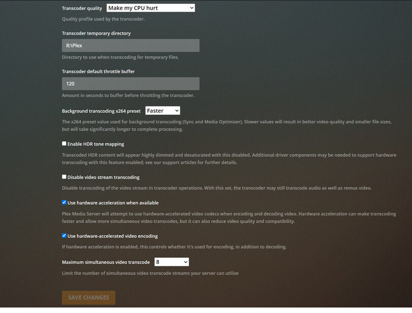

have tried 20meg 12meg and smaller. it doesnt matter. i have hdr tonemapping off. i have tried old drivers and new drivers.

adding that if i disable hardware encoding and decoding plex wont use both physical cpus. only using 1 numa node. so with 1 10 core cup it cant keep up. with 2 it could but its not using both.

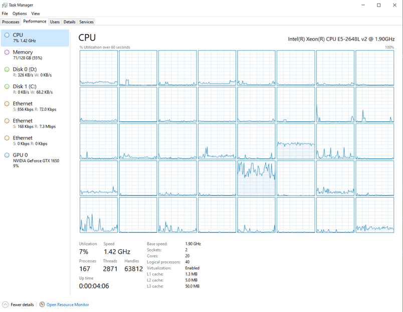

and as u can see cpu hardly being used for the transcoder for audio.

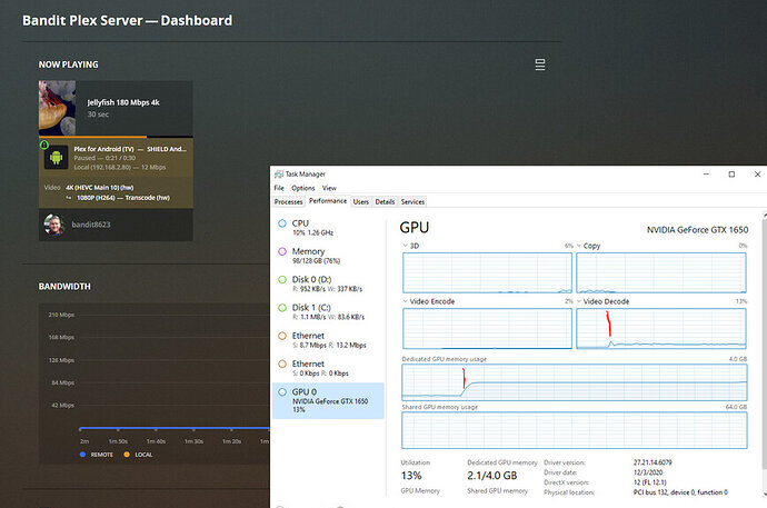

so tried to play the jellyfish files. all 4k hvec files play direct play on my nvidia shield. switch the bitrate to get it totranscode will play for 10 seconds and buffer.

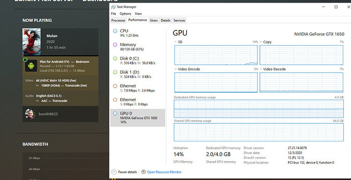

added a ss on the start time of playing the file and gpu usage, this was the 3rd time trying this and the video was buffering about 10 sec after playing.
also tried playing the file directly on my server same problem as my other networked pc. the file bufferes for 30 seconds and then just exits.

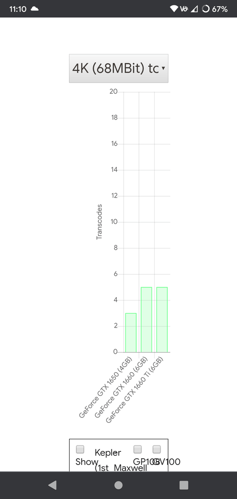

A 4GB gtx 1650 should do three 4K > 1080 transcodes so 30-40% for one stream is about right.

So is the calculator incorrect as well?
