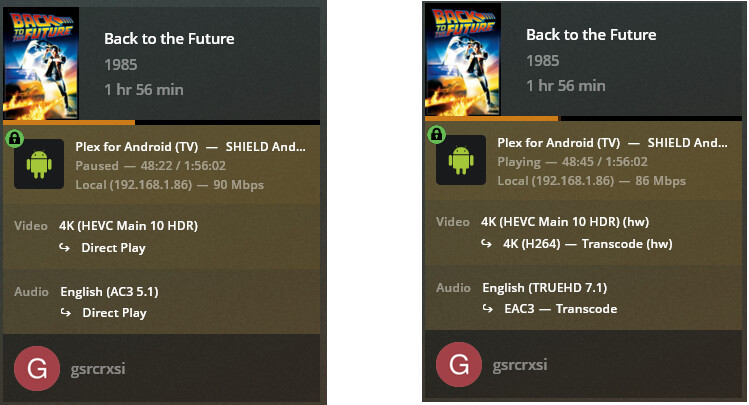

So here’s what happens. Whenever I end up in a scenario where the server is trying to Transcode 4k->4k, with HDR tone mapping and nvidia hardware acceleration enabled, the entire server crashes. it literally just powers off ungracefully. I know historically this kind of thing is caused by a hardware problem, but I cannot find an issue with the hardware at all and it only happens under these specific circumstances.
I first thought this might be an issue related to TrueHD audio being transcoded, but after many test cases, discovered it is only a catalyst, not the cause.
I’ll try to list all the situations and permutations i’ve attempted to test:
  1. 4k video + AC3 5.1 audio + HDR TM=ON + HWaccel=ON -> everything Direct Playing
  2. 4k video + TrueHD audio + HDR TM=ON + HWaccel=ON -> server attempts to transcode TrueHD->EAC3, which seems to force a video 4k->4k, and server crashes. needs to manually power back on.
  3. 4k video + TrueHD audio + HDR TM=OFF + HWaccel=ON -> video plays fine, transcoding 4kHDR->4kSDR on the GPU, also transcoding audio to EAC3 fine.
  4. 4k video + TrueHD audio + HDR TM=ON + HWaccel=OFF -> video plays, transcoding specs the same as in case #3, tone mapping working, but buffers a lot because the CPU is not powerful enough to transcode for real time playback.
  5. now if i take case #2, and manually select a transcode down to 1080p (20Mbps for example), before enabling the TrueHD audio it works as it should with TrueHD audio being transcoded and no server crash. it plays at 1080p as instructed and tone mapping and nvidia hw accel both working as they should.
  6. now i took another 4k file with DTS HD-MA audio + HDR TM=ON + HWaccel=ON. My client can direct play this audio so it’s not forcing the video to transcode and plays fine initially. but if i select “Convert Automatically” from the quality settings, it will attempt a 4k->4k video transcode at first and crash the server just like in scenario #2.
So it appears we have two issues.
First, there is some conflict happening with the specific situation of 4k to 4k video transcoding with HDR tone mapping and HW accel enabled which results in a full system halt.
Second, I can’t see why Plex is even trying to transcode the video component in these cases where it only needs to transcode the audio. I would avoid running into these 4k to 4k transcode situations if Plex only transcoded the audio and properly remuxed the video and audio streams like it should. I thought thats what “direct stream” was for? can anyone give a technical explanation of why Plex is not doing this? I know I’ve seen cases before where plex direct played the video and only transcoded audio and vice versa, but it doesnt seem to be happening on this new version.

example:
I have symmetrical gigabit internet service
Plex server-side stream limit set to original (no limit)
client = nvidia shield 2017, also set to stream with no limit and play original/maximum. it is also on the LAN with the server.
playing Avengers Endgame in 4k to my nvidia sheild with AC3 audio track selected, everything direct plays as it should. both audio and video are direct playing.
now if the only change i make is to select the TrueHD audio track (which is not supported by my hardware) Plex wants to transcode that, fine. but what’s not fine is that in this case it also decides to transcode the video with it. this is not desired. plex should be streaming the video and ONLY transcode the audio, not both.

so it seems to be a lack of a “remuxable profile” whatever that means. so uh, can you guys make that? what profile exactly is missing? seems like definitely a limitation in Plex, since the hardware can do it.
here you can see another example. with HDR tone mapping disabled to prevent the system from crashing. but you see direct play, then all transcode just from changing the audio.
is it because Plex decided to transcode the audio to EAC3 and there is no 4kHEVC+EAC3 combo available for muxing? if so, maybe plex could be a little smarter to choose an audio codec to convert to that can still be remuxed?
