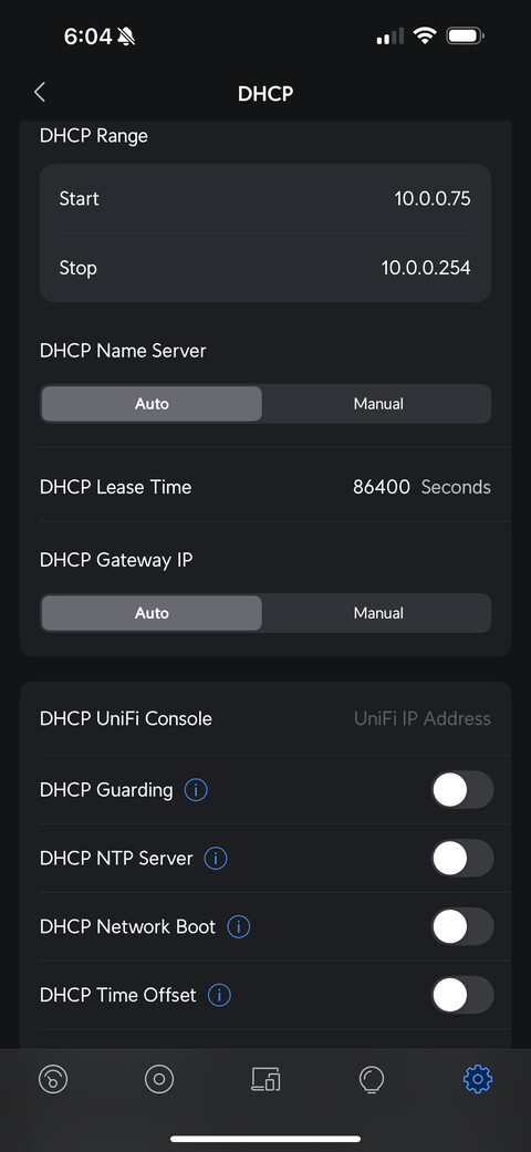

Does the server have a static IP address?
I have it set in my Unifi Gateway as a fixed IP

DHCP reservations (which you show me here) have a duration.
In your Unify settings, what is the DHCP address duration ?
The default should be 86400 seconds.
It can be set to longer periods if desired.

Ok found some reddit posts with people with similar issues for the network change stuff. Only thing people figured out was that it was related to Docker using Network Host mode. So I switched the container to Bridged and no more Network Change in the logs so far.
I tried a movie out again and its still doing the buffering issue.
