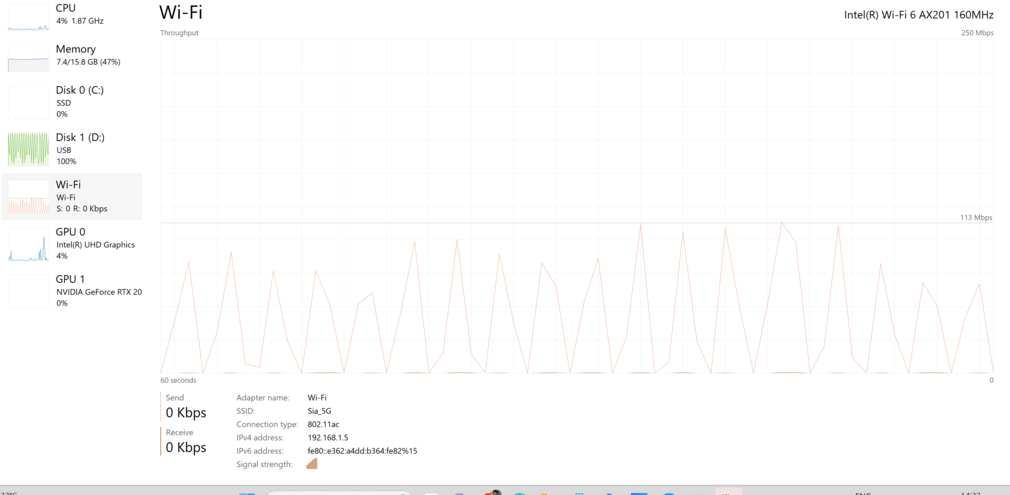

The media files are stored in 10Tb hard disk which is connected to laptop running plex server.
Here is the disk & wifi usage from task manager
Yes they do reach 100% load but its not constant peak & its same when i run lower bit rates 4k movies but those run normally.
