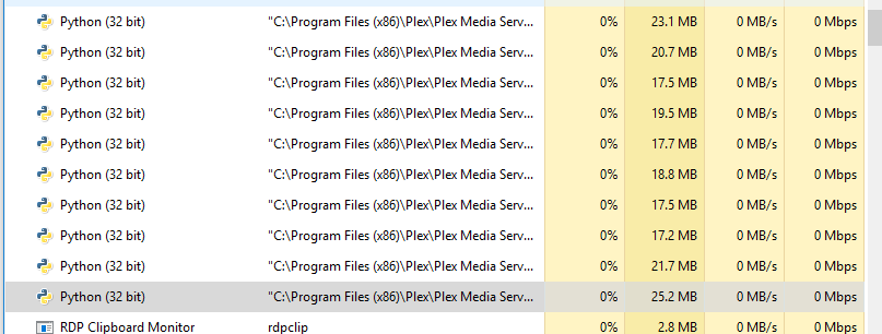

I also noticed when I went in and killed everything in order to restart plex there was a bunch of plex python scripts running. not sure what the normal number is or if it’s even related but it’s something.

That said, it hasn’t happened since I killed all those python processes. Unsure if that’s luck or related.
