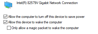

Anyway to get this to work with magic packet? when I have pattern match selected, my computer can’t stay asleep for more than 3 seconds before it powers back up.
I finally was able to track it down to my Ethernet card. Disabling pattern match and having all other settings enabled I can sleep properly. Obviously this causes a problem as my plex content is not available now. Might need to run it 24/7 if I can’t make it work on magic packet or find out why pattern match doesn’t keeps it awake.

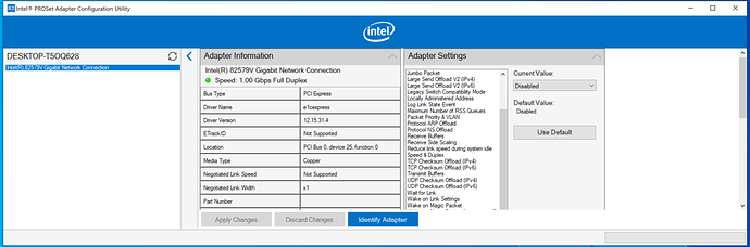

Has anyone tried to use this utility yet?
Along with the advice to disable “Advertise as player” and using this utility I’ve got my server to sleep and wake perfectly. Seems to give you a lot more options to dig into.

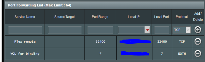

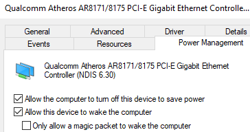

@SunnyDays; just wanted to thank you for your clear and detailed information. I was able to get WOL working perfectly on my system
Dell XPS 8920, Win 10, with Qualcomm Atheros NIC
Created inbound and outbound rules for port 32400 in Windows Firewall as suggested
Asus AC1900 router
Set up port forwarding for ports 32400 and 7, and port triggering for 32400
Everything works as hoped for. My server pc wakes up when accessed by my iphone or Roku box connected to my home network by wifi, and also when accessed remotely by my iphone over cellular connection. And my pc goes back to sleep as expected, in either situation.
Thanks again for the great tutorial instructions!
