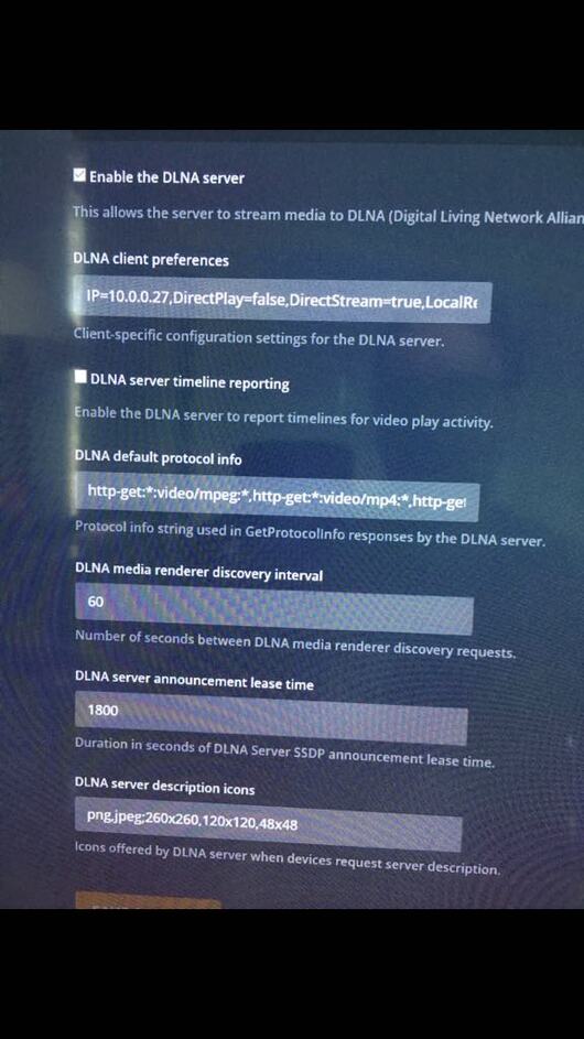

Hi guys
Before I happened to format my Windows drive just recently, I believe I had found the DLNA ‘Client-specific configuration’ script to allow the Plex DLNA service to sleep the PC whilst DLNA was still enabled & when not in use, as it indeed was working.
I have attached a screenshot of most of the script itself as I happened to take a photo before formatting, however the one thing I did not do was copy this whole script before formatting the drive. I found this script listed somewhere on the net (I cant remember) a few years ago when I was having the same problem. Is anyone able to complete this script’s complete wording listed under ‘DLNA client preferences’ in General in the PMS Windows settings? If you can, please list it here, as it would be much appreciated!
