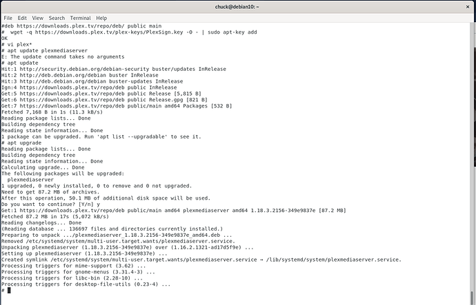

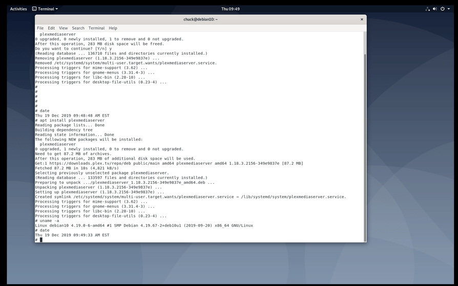

Cannot recreate on Debian 10. Continuing to investigate.

As you can see, I can’t recreate it. I just did it again.
What’re the differences here? I have a stock installation in the VM for dev & QA purposes.
