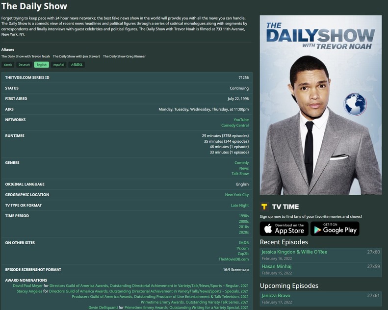

Multiple information providers (aka agents, aka scrapers) used by both Plex and other media center software (Kodi) such as TheTVDB.com and TheMovieDB.org use meta data that has the show starting in the year 1996.
The problem is that Plex DVR is creating folder names and file names with the show starting in 2015, and thus the the current episodes from 2022 are labeled as Season 7. But all the agents/scrapers believe it is season 27, so the meta data (posters, guests) are from episodes back in 2002.

Not sure if it matters, but the information in the Plex DVR → GUIDE looks to match with what is in TVdb, EXCEPT for season number.
I think that makes sense, based on what you’re seeing. Gracenote is treating this as an entirely new show; TVDB is treating it as an ongoing show. The split occurred at season 21 (1) so everything else (episode numbering) should line up. So I don’t think this is inconsistent with the idea that the EPG metadata is being dropped and replaced.
