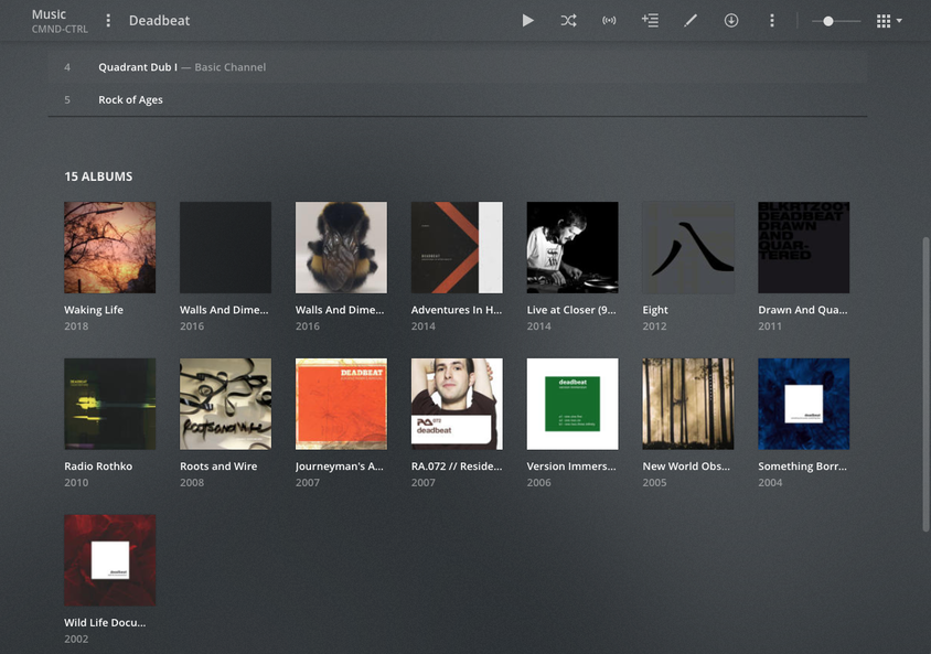

So here’s an example screenshot of an album (Walls and Dimensions) that’s not showing album art, despite it being embedded in the files.
If I do a “Refresh Metadata” it will find it the artwork and display it properly… for a few days, then it goes back to being a gray circle. I think it has something to do when Plex “refreshes local metadata every three days”. It seems to coincide with that.

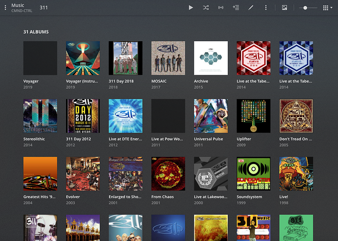

Anyone know what’s going on here? Still happening on certain albums. I refresh metadata and the covers come back, but then disappear at some point later. Always the same albums.
Still having this issue. I’ve tried moving the cover art out of the files (embedded) and into a sidecar file (folder.jpg) and that unfortunately didn’t work. Strangely, it is always the same albums, although I can’t find out why; it’s the same 5-6 albums.

Here’s another example? Why? I’ve had the cover art both ways; embedded in the files and as a sidecar file and I still get a blank cover art image. The art will be there for a little while, then disappears. If I do a Refresh Metadata it comes back for a little while, then disappears again.

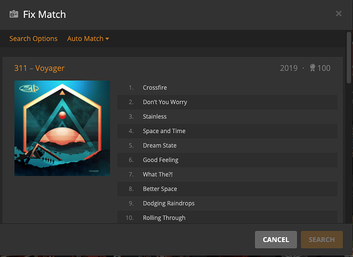

Yes, they appear to be matched because when I click the three dots on the album, I am presented with “Fix match” and " Unmatch" Options.
Screen Shot 2020-04-20 at 7.20.49 AM
Is there another way to check? That is the only way I know how to figure it out.
