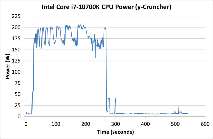

There is more to it than that. The i7-10700K (according to AnandTech) can peak at 200-230W. It can be much higher than 125W, so make sure to accommodate with your cooling. You will find yourself thermally limited if you use a subpar heatsink or have too little airflow. Are you worried about power use from a power cost perspective or just cooling?
  • Core i7-10700K: TDP is 125 W, PL2 is 229 W, Tau is 56 seconds
  • Core i5-10600K: TDP is 125 W, PL2 is 182 W, Tau is 56 seconds
