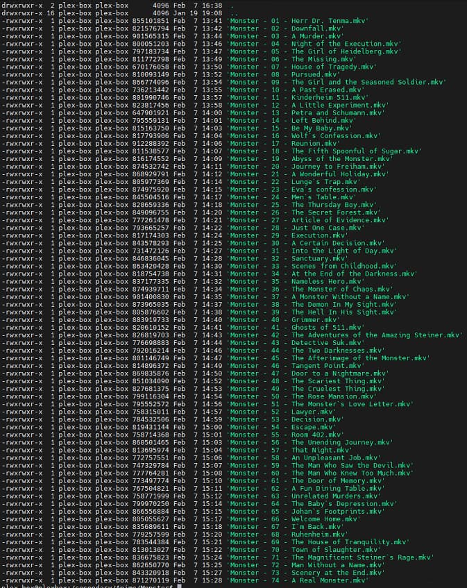

Here is what files look like on server:

So dokuro is right, plex was getting confused on the naming of the files, so i helped out plex by removing any numbers that were in the file name that it could choke on and this solved the issue.
ie:
mv 'Monster - 55 - Room 402.mkv' 'Monster - 55 - Room.mkv'
mv 'Monster - 11 - Kinderheim 511.mkv' 'Monster - 11 - Kinderheim.mkv'
mv 'Monster - 41 - Ghosts of 511.mkv' 'Monster - 41 - Ghosts of.mkv'
Now episode 55 works correctly and plex automatically retrieved the title of the episode
