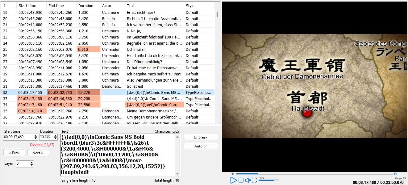

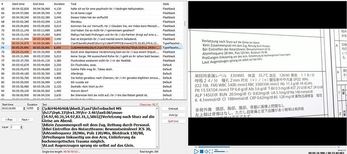

However, there are notable issues with heavily styled subtitles, especially those that occupy a large portion of the screen or remain visible for an extended period:
  1. Scenario 1: For subtitles that are highly styled and span across the screen, playback becomes extremely choppy, with display FPS dropping below 10.
  2. Scenario 2: When subtitles scroll or persist on the screen for longer durations, playback becomes laggy and causes the Plex app to crash entirely after ~10 seconds.
This indicates that there are still major challenges with handling complex subtitle rendering.
