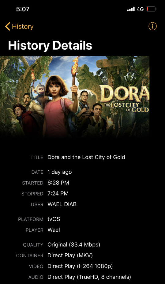

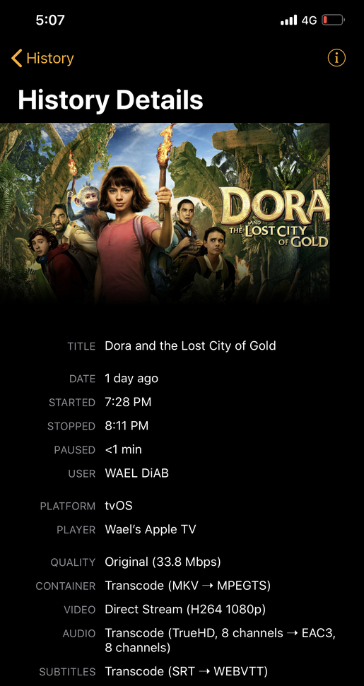

You are mistaken. Infuse can play the Atmos check the attached screenshots. I was able to play the Atmos without any problem. The first photo is the direct stream of the Atmos through Infuse and second photo was played with plex.

I am not mistaken, the Apple TV in fact does not support Dolby Atmos via TrueHD. It does not even support TrueHD.
I see no evidence from your screenshots that Dolby Atmos has been played, only a TrueHD stream, which Infuse locally decodes to LPCM and bit-streams to your receiver (refer to the link @Daskew78 provided)
I will say again, and refer to the information @Daskew78 gathered from the Infuse team:
TrueHD and Dolby Atmos are not the same thing. TrueHD is a lossless audio format/codec. Dolby Atmos is a metadata layer encoded into that audio codec, and can exist in (as of today) either a TrueHD or E-AC3 codec. If the playback device does not support the codec (in this case TrueHD) then it cannot playback the Dolby Atmos metadata either.
Infuse is able to play a TrueHD audio stream by decoding it to a LPCM format, and in doing so the Dolby Atmos metadata is lost in conversion (repeat of previous paragraph, refer to the Infuse support page :nerd_face:)
