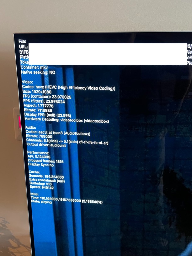

I noticed recently that playback of HEVC encoded 1080p content has very noticeable stuttering. Both audio and video are using DirectPlay and neither bandwidth nor CPU on the server seem to be the culprit. This is definitely something new because I used to be able to play the same content just fine.
Turned on debug output during playback and it shows significant frame dropping.
Is this a known issue? If not, what other data should I gather to help investigate this?
