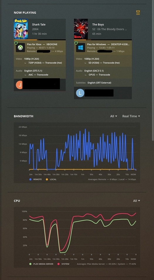

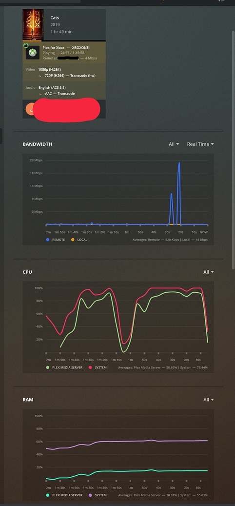

These are two examples of the high CPU usage.
