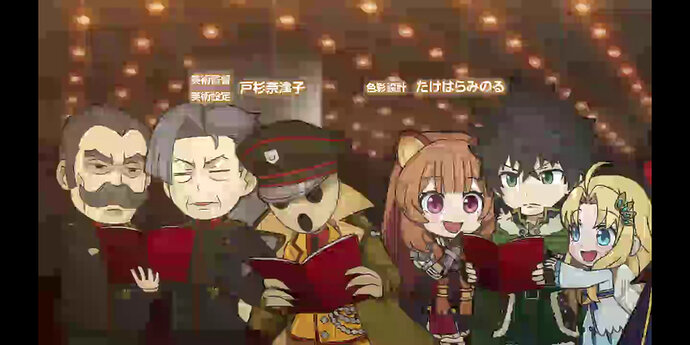

@sa2000 Is the development team aware of the artifacting resulting from using hardware acceleration transcoding with integrated intel graphics? I have a bunch of anime content that has subtitles. With the the TVDB scraping set to stop working as of 1/31, this has forced me to upgrade to v1.18.4.2171. Here’s several examples below. I might add when I was on an older version of Plex Media Server (I believe 1.16.xxxx) this was not an issue. This has only started recently when the new transcoder was introduced.
I’m running an i5-7600k w/ Intel HD Graphics 630 using drivers v26.20.100.7584. (I’ve also downgraded and tried with other their older drivers… Same results)

I screen recorded a short recording of the video showing the artifacting:

And here’s a recording of the same video utilizing transcoding w/ PMS v1.16.5.1554:
sample trancoded PMS v1.16.5.1554.zip (10.0 MB)
Both these demonstrations were on an i5-7600k utilizing Intel’s HD Graphics 630 with driver version v26.20.100.7584 on Windows 10.
