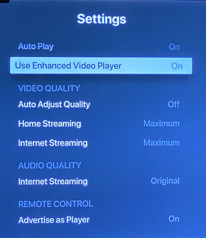

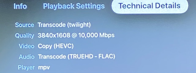

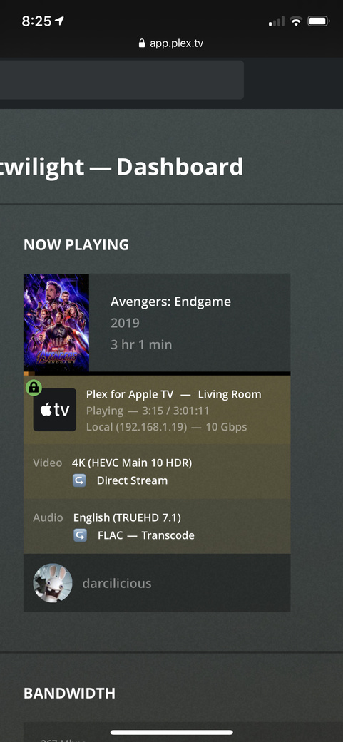

First, make sure the Enhanced (Experimental) Player is enabled in the Plex app on your Apple TV 4K.
Next, use these settings on your Apple TV:
Then be sure you have these settings on your Plex app:
And during playback you should see something like:
And this:
