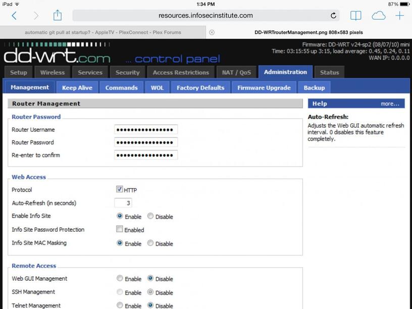

I was thinking we could have a cgi front-end that runs prior to plexconnect.py that would be able to stop/update/restart plexconnect using a web-browser on demand. I set it up for OSX but haven’t found a way to get it running prior to plexconnect yet. It’s in alpha stage so it could be improved on to add support for any device/os so you can manage any function needed in any browser I would imagine.
I actually got the original idea from a ps3 cgi program called webman and was hoping a similar option could be ported into plexconnect like loading movies or something else via any web-browser any device. I would imagine almost anything with cgi is possible here is a example of what cgi can do (just tap a game and it loads on the ps3) definitely would make for a sick looking remote :smiley:
Most if not all modern routers today are built using cgi for web-management.
