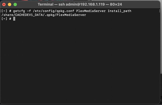

I can’t even enter through a terminal! and on qnap I turned on SSH. QNAP account is what? your username, device name, email address? I’m already stuck here, so I said Chinese to me :laughing:
so far i got it! I won’t get any further from here.
Will Q exit the connection to the QNAP (returning to the Mac’s shell) or simply exit the “Console Management - Main menu”?

commands should be the same as listed above (the paths match those from the examples:
cd "/share/CACHEDEV1_DATA/.qpkg/PlexMediaServer/Library/Plex Media Server/Plug-in Support/Databases/"
cp com.plexapp.plugins.library.db com.plexapp.plugins.library.db.original
/share/CACHEDEV1_DATA/.qpkg/PlexMediaServer/Plex\ SQLite com.plexapp.plugins.librrary.db ".output recover.out" ".recover"
just like that I typed them in and it goes in. does it run into the background? can i close smoothly? how do i know if the operation was successful?
It’s 3 separate commands you need to run after each other. From the looks you copy & pasted a fraction from all 3 lines?!
yes i just extracted them all and just pasted them. I always printed an enter between them!
