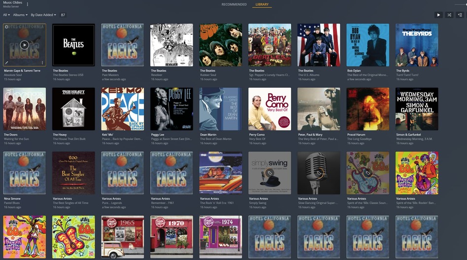

They all say Various artists and the same album 100 hits the midnight special.
That’s the problem right there.

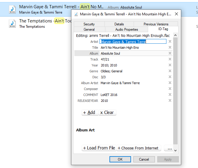

Thanks - good question - this is a sample file it didn’t gather any info for.
If you could show me where to make that adjustment to use personal tags I would greatly appreciate it.
The linked phrase in my post takes you to instructions.
The track in your screenshot does show the embedded “Album Artist” is “Various Artists,” so your tags may need some work.

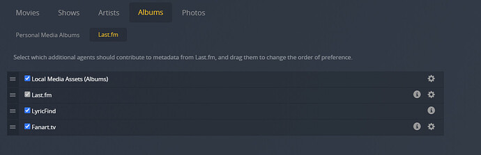

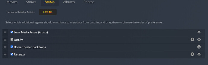

I took a picture of my settings as they seem to be slightly different in my version of Plex.

This is the result I’m getting with these settings.
Here are my agent settings
There are a lot of problems in these tags. The artist name isn’t complete, the track title isn’t complete, the Track number (47/21) is really weird (track 47 of a total of 21?), and the disc “3/3.” As noted in the How-To article, including the totals in the track and disc fields can cause problems for Plex. This is why I said “If your tags are very accurate, Plex will do a pretty good job…”
Your settings look fine. On a side note, I’d recommend against using the “Store track progress” setting. This setting is intended for audiobooks, and it may be nice with hour-long music files, but most find it problematic in a regular music library. It won’t be the cause of the issues you’re having, though.

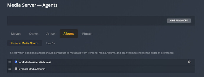

You might be able to get what you want by using the old Plex scanner and the Personal Media Artists agent, as seen below, because I don’t think it queries MusicBrainz, but:
  1. I don’t know if it will work.
  2. The ‘Plex Media Scanner’ scanner is outdated. I don’t think they’ve said it officially, but since it has been replaced with the new scanner, I would expect it to go away at some point.
  3. You’ll also be losing some of the features (not sure what those are) that the new scanner makes available.

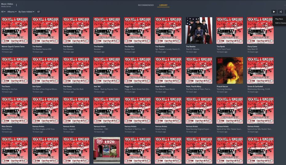

It was getting some of them right -
But at the more it gathered the more it eventually turned them all the same.
