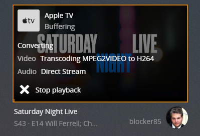

OK, so recording TV shows seems to work without issue. However, when I try play the recordings back on my ATV4 (or any other client, for that matter), I get a ton of buffering and a message saying that my server is not powerful enough to playback the media file.
When I check my unRAID dashboard, it shows that my CPU usage isn’t even cracking 30%. Also, when I restart the server, the issue seems to go away for a day or so and DVR recordings play back without issue.

It is transcoding the video. Here is what I am getting with the ATV4 on a DVR recording:

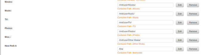

Plex is transcoding to /tmp.
h
Any advice is appreciated!

You say plex is transcoding to /tmp, but in your screenshot it says it’s going to /transcode. I’m not sure which is correct, but again check the speed of the disk in that location. Perhaps you don’t have a fast local disk or it’s low on space?

There are two types of transcoding that I refer to in my posts. The first is the on-the-fly transcoding for DVR recordings so that the resulting file is not a raw .ts file. That transcoding is turned off. The transcoding you see in my screenshots is the transcoding for playback of any media file in my Plex library.
If I turn off transcoding entirely, will my ATV even be able to direct play the raw .ts file that Plex outputs for DVR recordings?

Because this is an unRAID box, I run Plex in a Docker container, which requires that I give Plex only certain access points to the underlying linux file system. /mnt/user/TV is the local path to my TV shows on the unRAID box. This appears as /TV to the Plex Docker. This also may be your confusion regarding my transcoding location. /tmp on my local system is the path necessary to transcode in RAM, but Plex sees this as /transcode. You can see that in my Docker screenshot above.
