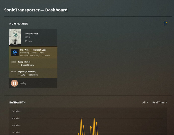

What information is showing in the “now playing” tile for that playback on the Plex server dashboard when you try to play that video through Plex Web?

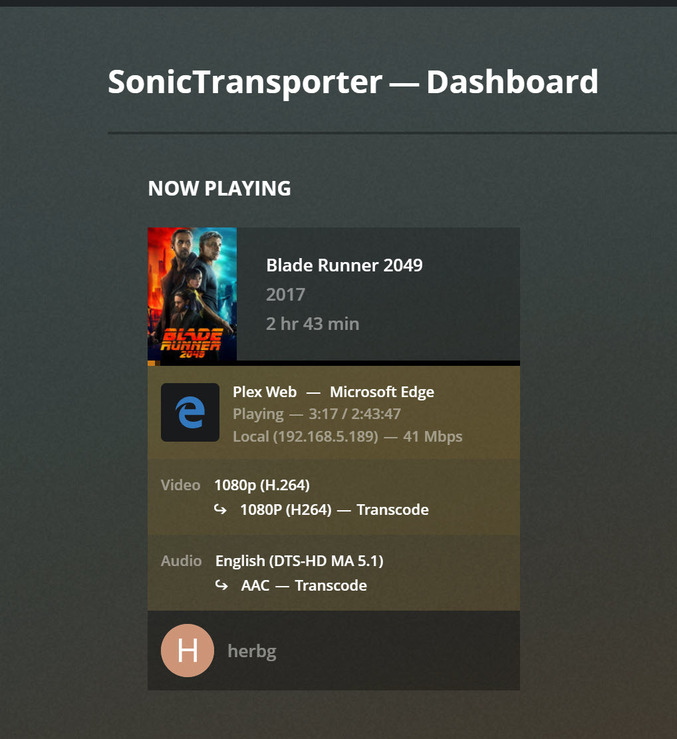

Exemplary screenshot from the "now playing" section
Here’s an example of a movie (The 39 Steps) that just doesn’t seem to load using the PLEX app in WIN 10 (MS Edge). This movie just doesn’t play in this environment.
In this case, I’m not using the WIN10 desktop app. I’m using PLEX launched directly from the SonicTransporter (http://192.168.5.144:32400/web/…).
If those network bandwidth peaks showing at the bottom of your screenshot are real, I suppose this will explain some of your hiccups.
How is your client connected to that server of yours (e.g. wired vs. wireless, directly connected or through a number of network components)?
610 Mbps is quite some load and could be too much for some networks.

Noticed this error message today … where is the disc space this error is referring to? Is there a setting somewhere that I inadvertently changed when switching plex media servers? Could this be the buffering problem?
I only play direct streams (all transcoding done at the player). Do I have this section filled out correct:
Player’s do not transcode. Any transcoding is done by the server.
