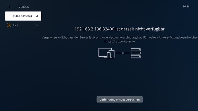

Yes, i have defined the server, see screenshot(s):
From what i understand, does the/my server? reject the request to “192.168.2.196” because the origin of the request is “file://” and not “plex.tv”, I may be wrong, but thats how i understand it and how ChatGPT explains it.

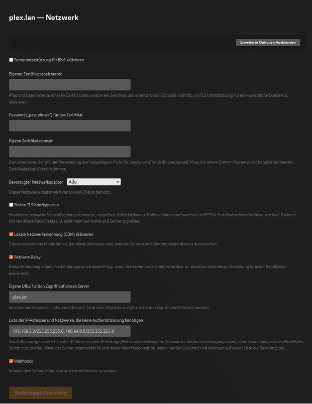

You mean Settings > Network > SSL/TLS? (https://support.plex.tv/articles/206225077-how-to-use-secure-server-connections/), yeah, its disabled.
HTTP only, no HTTPS.

This is the setting I was referring to =>
Probably that’s the one you also mean.

Yes,

Complete Network Settings:

Also, you should note that the server preference for IPs allowed without auth should not have spaces in it. With spaces, it’ll fail to parse what you have, log it, and act as if it is not set.
