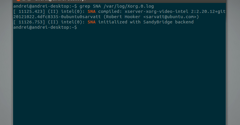

I wonder if this is something that I can adapt to CentOS: How To Enable Intel SNA Acceleration In Ubuntu ~ Web Upd8: Ubuntu / Linux blog
Not related to Plex at all. “SNA is a 2D acceleration architecture for the open source Intel Linux graphics driver that provides improved X.Org driver performance”.
