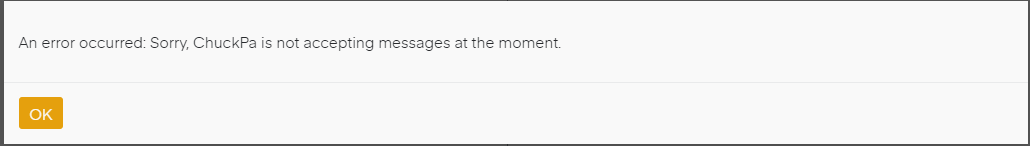

I can not send it to you tho:
@ddrones
I have opened a PM for you to attach logs
