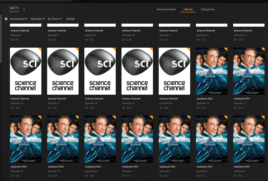

To add to my above,
In the Library view,
Change “ALL” to “Unmatched”. (dropdown)
next change the display to whichever granularity you like.
Here you can see where my test library ‘runs off the end’ of legitimate series.
The non-existent / unmatched episodes show here.
