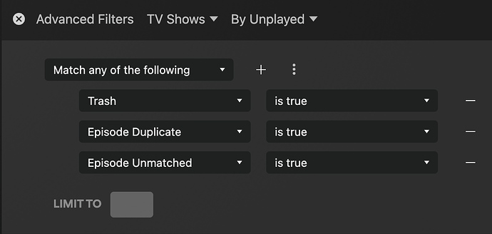

I’ve changed “ALL” to “Unmatched”, the result is “The active filter has no matches”. I will look into WebTools-NG, but as far as I can tell the episodes are not showing up in plex at all, not een as inmatched
Additionally I tried searching by duplicate episodes among other things, no luck:
@ChuckPa I couldn’t find any unmatched or duplicate episodes on my plex library. As for WebTools-NG (this is a cool tool), I assume you were referring to the “Find Media” option? This did not show these files at all. But I can see them present on the drive via ls as demonstrated above.
