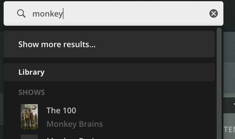

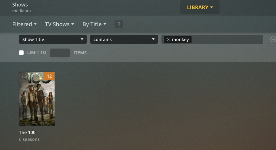

it is working fine here. Unless I am not understanding what you are trying to do. The original title does not really show up anywhere but you can use it to search . and the summary saves fine for me.
changed original title of the show The 100 to ā€œMonkey Brainsā€ and hit save. now i can search by monkey and find that show

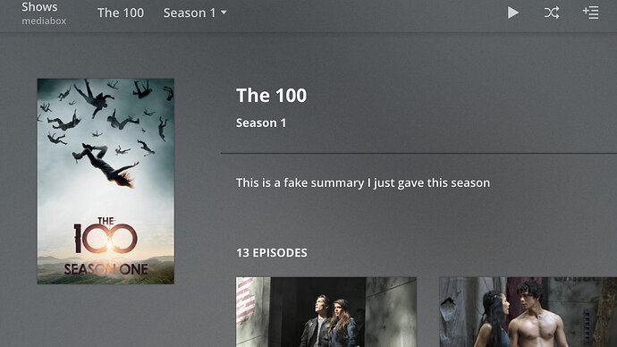

The fake season summary I added shows up fine too.
