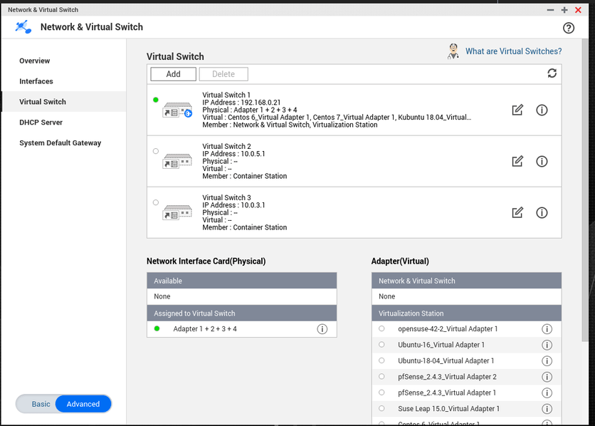

I think I have figured out how to make it such that PMS doesn’t get confused.
The ‘trick’ is the enumeration sequence.
- Create the network (Bond) first,
- Add the V-switch to push the IP out, making it the default
- The containers and VMs will fall in line and into the V-switch. They will be NAT uncoupled or Host IP

Here you see the enumeration sequence and how it looks when illustrated.

In 4.3.5 B2, you’ll spot the network adapter enumeration changes.
Those are the current issue for most.
