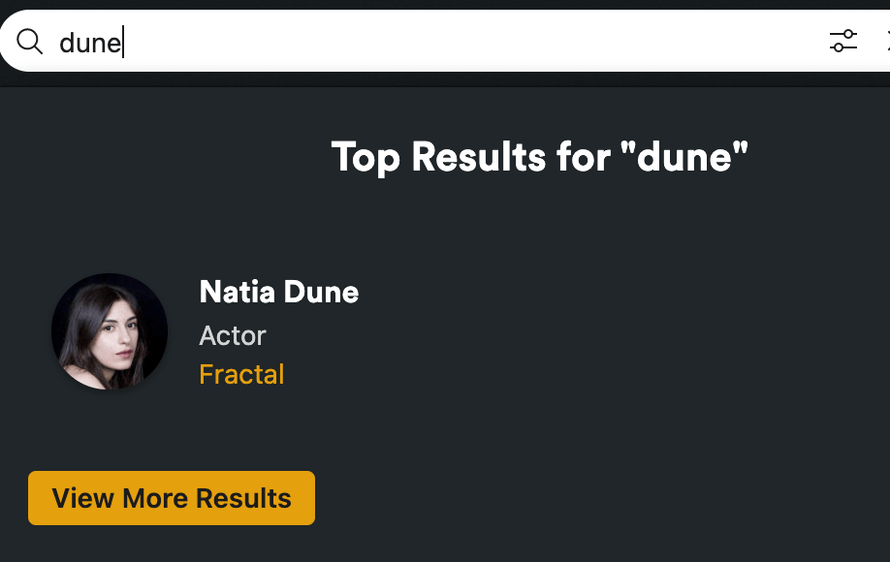

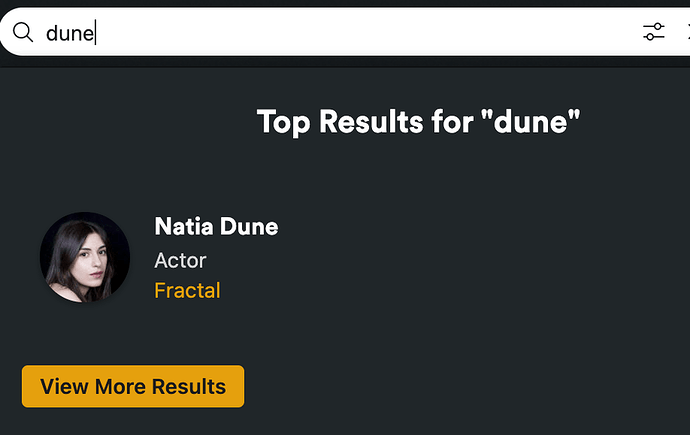

I cannot find a movie by its original title (movies are on my server):
  1. My library language is set to Polish.
  2. When I want to find “Dune”, I need to enter “Diuna”, otherwise I get nothing.
macOS+Windows: App Version 1.105.1.257-3bc35ab9 /// also tried Safari and Firefox
iOS: App version 8.43 (9570)
Server: 1.41.1.9057
This is extremely frustrating, because, for example, if I want to find Hateful Eight, I have to enter “nienawistna ósemka”.
My library agent is Plex Movie, same as scanner. All movies have original titles appended correctly.
What can I do to fix that issue?
Log snippet that shows the request is sent correctly:
Dec 10, 2024 00:07:33.663 [24260] DEBUG - Request: [[redacted] (Subnet)] GET /library/search?query=dune&limit=100&searchTypes=movies%2Cpeople%2Ctv&includeCollections=1&includeExternalMedia=1 (25 live) #49ac3 TLS GZIP Signed-in Token (Radeghost) ([redacted])
Dec 10, 2024 00:07:33.683 [15228] DEBUG - Completed: [[redacted]] 200 GET /library/search?query=dune&limit=100&searchTypes=movies%2Cpeople%2Ctv&includeCollections=1&includeExternalMedia=1 (25 live) #49ac3 TLS GZIP 19ms 712 bytes (pipelined: 7)

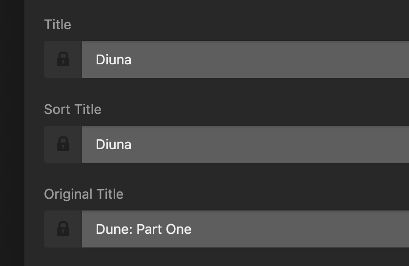

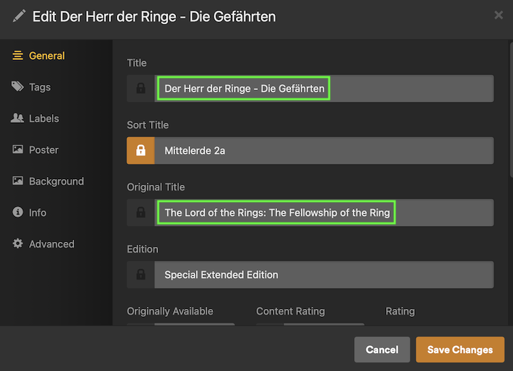

What agent are you using for this library of yours and does it populate the Original Title attribute (:pencil2: > General)?
Plex Movie is both agent and scanner. Title is title in my own language, where Original Title is original.
