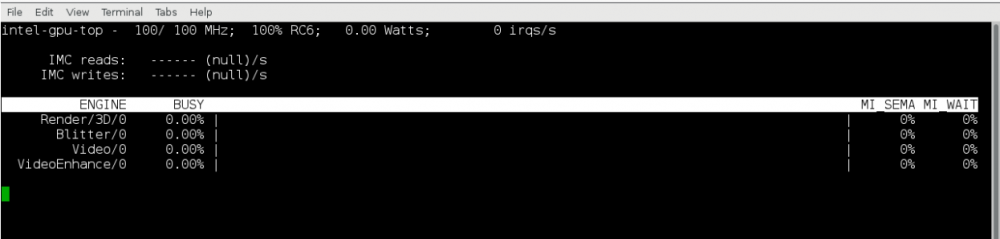

So far all looks good but when I force trasncoding by lowering the stream quality I get no video. It just seems to be buffering endlessly, yet in the dashboard, I can see HW transcoding is ongoing:
plex
I have also checked the Plex logs quite extensively and it appears that the transcoder is working fine and is actually using HW acceleration as well.

Just an excerpt, full logs attached if anyone is interested in taking a look at them.
Any ideas as to why I am not getting any video even though the transcoder appears to be working fine will be much appreciated! :slight_smile:
Plex Media Server Logs_2019-06-19_16-27-36.zip (2.1 MB)

However, as mentioned above, even though all seems to indicate that the transcoder sees the iGPU and is trying to use it, looking at the iGPU utilization through intel-igpu-tools, the device is idle :frowning:
EDIT: Just tried the official plexinc docker image instead of linuxserver’s and it behaves the same.
you will find more help here -
Uhm, unfortunately not. I’m positive that my config is OK (definitely does not differ from the guide in the thread you’ve linked). As stated above, it appears the transcoder is aware of the vaapi device and is trying to use it. I can see that in the logs and I can also see files/chunks being created in the /transcode directory. It’s just the playback won’t start and keeps buffering instead.
Just downgraded to UnRaid 6.6.7 and HW transcoding works as expected.
ah yes i did just see some talk about that in the linuxserver thread today
