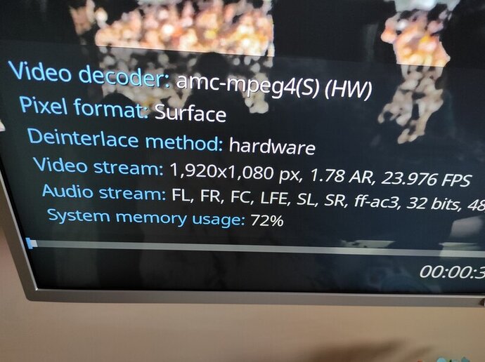

I’m not sure that use software decoding. When I play it with Plex add-on for Kodi player info show amc-mpeg4 (S) (HW)
Your log doesn’t show me enough to know what hardware support your box has, but the trasncode reasoning indicates the device told the Plex app the video wasn’t supported. It’s possible Kodi is ignoring/not using that info and just playing the file anyways.
