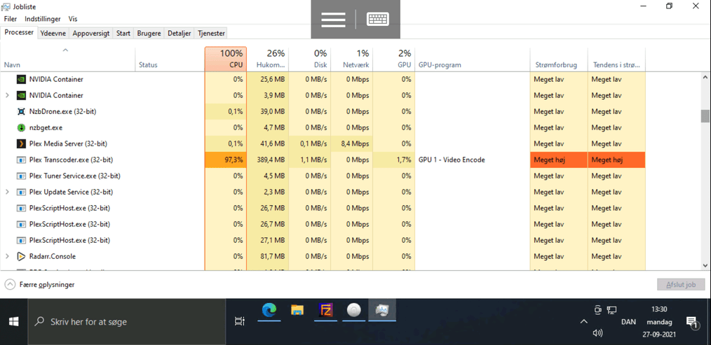

When playing it seems the GPU is very low load, I don’t know if this is expected ?

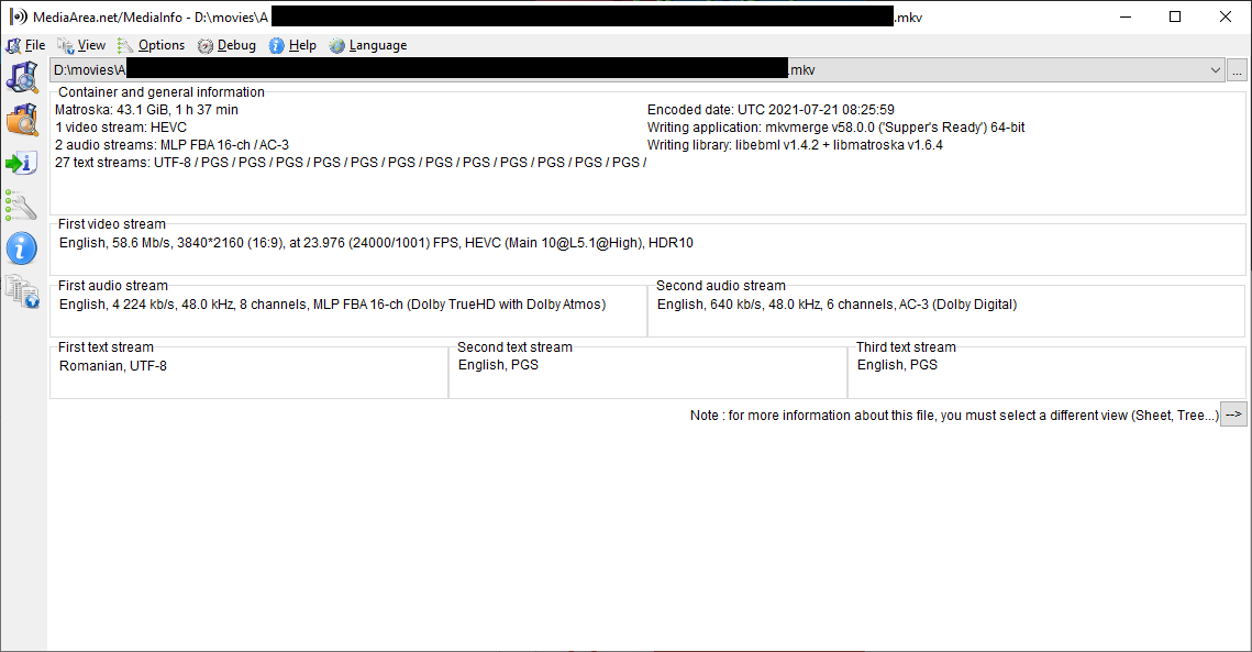

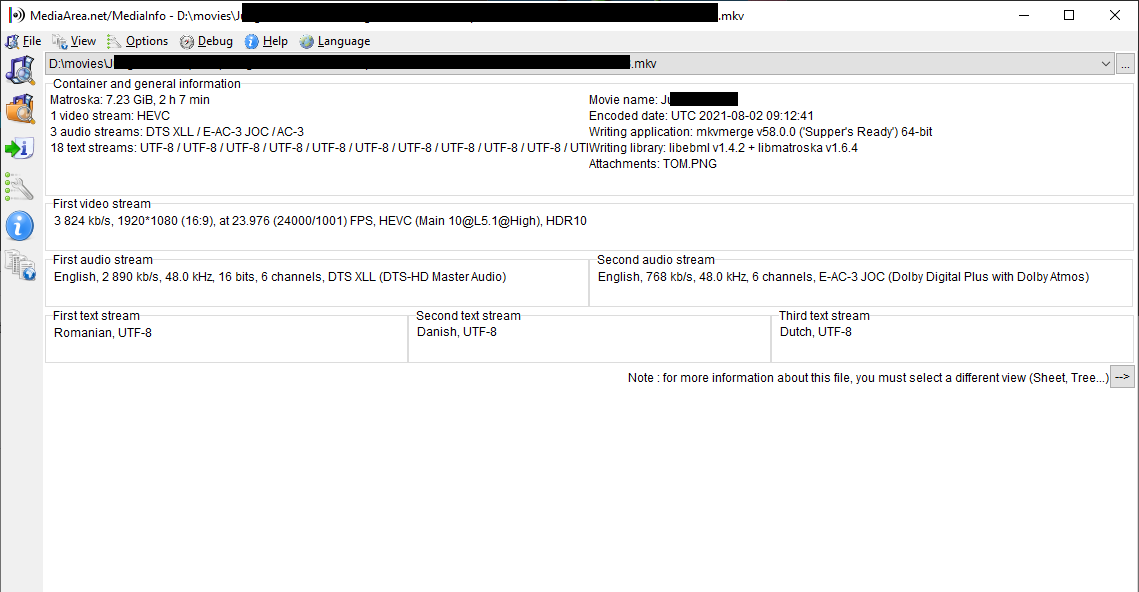

Attached is some info on the movie files and a screenshot showing that CPU is like 97% and GPU below 2% (it goes between 1-4%)
I know the CPU can’t handle 4K videos, but I really thought adding an old GTX 970 would make some kind of difference.

The screenshot above shows the movie has 27 subtitles embedded in the file.

What happens with the 970 & HEVC media:
Look in the decode portion of the Nvidia web page. You’ll see the 970 cannot decode HEVC/H.265 video.
This means Plex will try to decode the movie using your server’s CPU. Decoding is CPU intensive, so your CPU immediately goes to 100% utilization. Furthermore, the 4690K is no where near powerful enough to decode 4K HEVC video in real time, so you experience buffering when the video pauses to let the CPU catch up on things.
