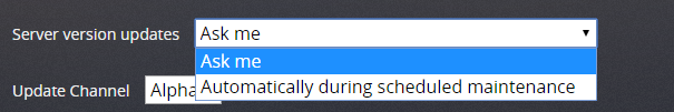

Thanks, now I need to find out who in my household did it. Is it possible to not notify of updates in any of the clients and only have it popup on the server as a balloon notification? I run my server on Windows 10. I do not want it updating automatically.
I leave my setting for Server version updates set to Ask me so new updates are only applied when I tell it to which is always during periods with no recordings. I also generally test multiple simultaneous recordings over a couple of hours to make sure there are no issues with the new version. Only the admin account should be able to apply updates. I don’t get the notification on clients if logged in with other user accounts.
That is what I have. Until the Live TV and DVR are rolled out to non-admin users, everyone has access to the admin account. I guess that the risk I will have to take.
Yeah, that would be a problem. On the bright side that is a feature Plex is looking at and hopefully will be released in the near future.
