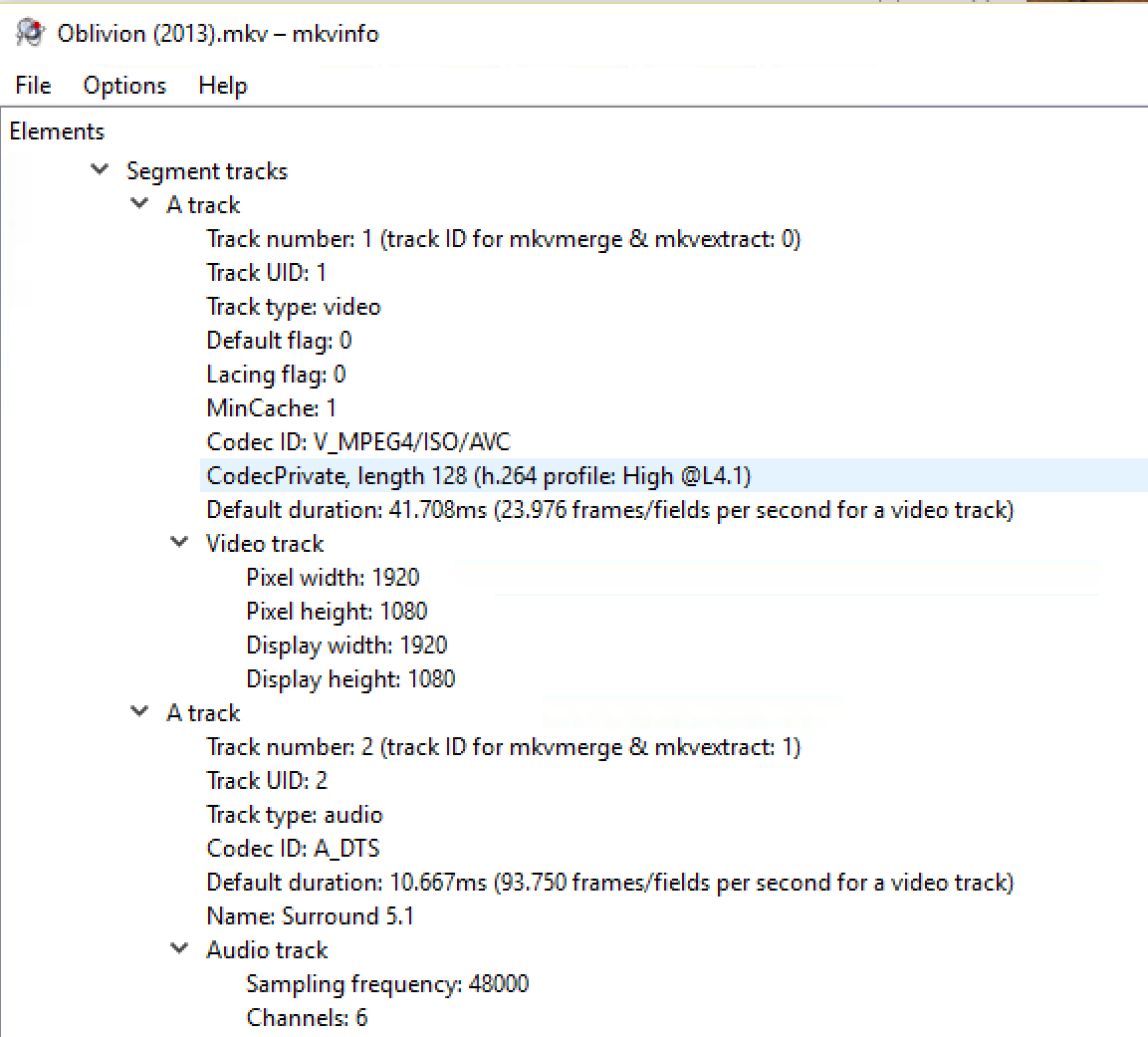

Typically, I take a new Blu-ray, Rip it using MakeMKV (with all of the goodies) and put in a folder that has the following type of structure.
Forgive me for not knowing much about video, but I believe this is completely uncompressed. And, I am okay with that. Every device in my house is capable of handling the 1080P and Direct Plays the file (possibly transcoding the audio).
Even Externally, it directly plays just fine. Sure its big, but even at 26 GB it only needs 3 to 5 mbps upload to make it work… Even if it does transcode, my server can handle it.
So, is there any real reason to transcode (other than space requirements)…

Interesting, I did not know that blurays are themselve compressed… You are right it was a h.264
Straight Rip it is then, I have plenty of space.
